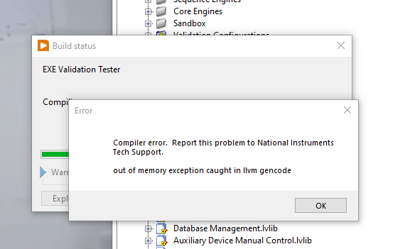

A decent amount, mostly just array manipulation stuff.  My build finished after only 2 attempts this morning resulting in a 100MB EXE.  Here was the first error from it.  I guess I can make my own thread talking about this, but I don't really have much to go on other than giving a huge project and dependencies to NI.  Maybe share a whole VM with them?
