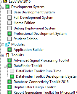

I have LabVIEW full development system installed and the application builder licence is active in Licence Manager, however, the application builder seems to be missing.

Under "Tools" (in any project) the "Build Application (EXE) from vi" option is grayed out, and Licence Manager says the licence is enabled.  (Sorry got it wrong,
 (Sorry got it wrong, its the "profesional developement system" I have a licence for.)
