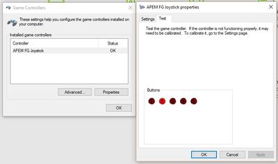

i have joystick with only button on it,
the device appear and working on windows (10) "Set up USB game controllers"
but dos'nt appear on the "Query Input Devices" vi....
any idea how to reach it?

I believe NI gets Joystick information from Windows's DirectInput functions.  On most of my PCs, DirectX returns 12-15 devices, with the "real" Joystick usually near the end of this list.  LabVIEW's Query Input Devices only returns the first 7 (or 😎 devices, so the Joystick just doesn't show up.

apparently, it's local computer issue..Smiley Sad
on other computer here the Query showing the joystick...

Yes, it is a local computer issue.  Depending on your hardware, and how many USB ports you have, and whether you have Bluetooth, and a bunch of other things, the Joystick might be enumerated in Direct Input slot 10, which means that LabVIEW, which returns fewer slots, won't "see" your Joystick.  I'll bet it you put it on an 8-year-old PC running Windows XP, it will show up.
