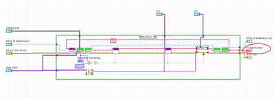

Memory is still continously growing and I see one more thing. Now my DMA buffer have some lag, and gave me always old data from aprox. 2s before

I've got one more question to you. In my application I'm using lvclass with ctl in which I'm storing data like process controls and 3 data plots. I'm continously putting data to it every loop cycle(example is in attached vi) and showing some of them on main front panel. Can I have memory problem from that? I assume that my lag in data from DMA buffer comes from high CPU usage, am I right?

To answer your question - it depends. Are you creating new class object every iteration? In that case memory may leak. If not, then it shouldn't occur. Why don't just use Cluster instead of Classes, does your whole application requires you to use Objective Programming? If you have high CPU usage, then definitely it will affect your acquisition and determinism of your application. For information about DMA FIFO behavior you should check them for Overflow and Underflow errors. Please refer to this article for more information: http://zone.ni.com/reference/en-XX/help/371599N-01/lvfpgaconcepts/fpga_dma_fifo_buffer_size/.

If you are using Classes properly then everything should be ok. Usage of clusters is just easier. To get more control over memory allocation of your queues you should use RT FIFOs, you can find them in Real-Time palette. The differences between standard queues and RT one you can find in this article http://www.ni.com/product-documentation/54516/en/. But as for the influence on memory problems, although you can check it, it is probably not the main cause. What is the level of cpu usage and memory leak that you encounter? I'm almost sure that somewhere in your code there has to be some iterating memory allocation, that we still cannot find.
I can see that in your Analog_In.vi you are unbundling and then bundling yours data class elements. You can try to do this operation in In Place Element Structure that may increase memory efficiency. http://zone.ni.com/reference/en-XX/help/371361P-01/glang/in_place_element_structure/

You were right. In my code I had one element that was continously iterating and when I removed it, everything works fine. Thanks for your help 🙂
