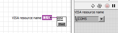

  1. Why have the Com port select a numeric then convert it to a string, then coerce that string to a VISA resource? Rube Goldberg much?
    1. Just create a control for the VISA resource

The first thing I noticed when I opened the VI this morning is that there was no VISA Open call.  I accidently removed it while reducing the VI to "simplest form to demonstrate the problem".  Reduction into obscurity, oops.
