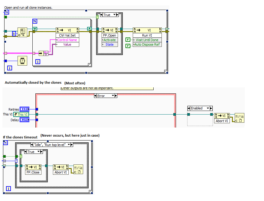

@Foreshadow20 wrote:
Basic info that can be skipped:
I have an application (test sequencer) that uses 2 types of reference and I seem to have a memory leak. Yes You DO!
I wonder if the Main application is still considering as open reference when the windows are closed through user manipulation or VIs being self-closed.
First Asynchronous Type: Debugging windows
2 types:
Running VI: A complete VI with JKI State machine
Static Front Panel with indicators
Second Asynchronous Type: Multiple Clones
Bothe examples Use the Run vi method poorly.  The Caller will keep the vi ref open until it goes idle.  If you changed the Auto-Dispose of Ref to TRUE the ref would close when the clone goes idle  Closing it in the callee is a no-op because the owner of the ref is the caller.
Better, Stop using run.vi method and use the ACBR that is exactly what it is there for
