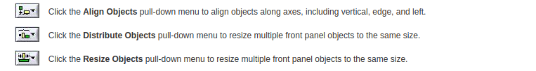

is it possible to programatically arrange front panel controls in the same manner as these tool bar actions do?

I'm curious as to where you go the image from that you posted.  The Distribute button seems to incorrectly have the same description as the resize button.  Even the description for the Align button doesn't seem accurate.

I'm fairly sure that is straight from the getting started guide
taken from here: https://www.ni.com/en/support/documentation/supplemental/08/labview-front-panel-explained.html
