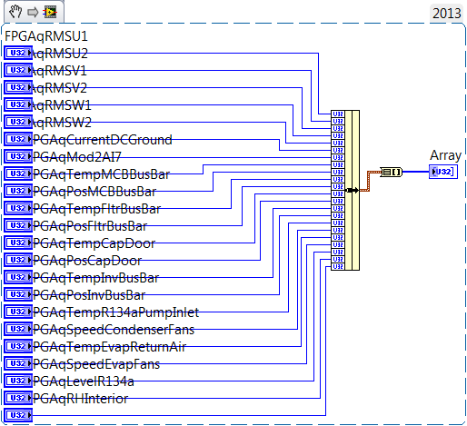

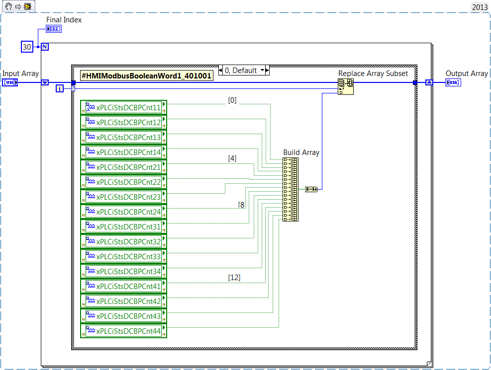

Reviving this old thread. I need some tribal knowledge.
I have a cRIO system, developed in LV2011 that is crashing - apparently running out of memory. Using the VI analyzer tool kit on similar VIs in a LV2013 project, I discovered some bad practices that I must blame myself for. Chief culprit right now is the 'Arrays and Strings in Loops' error. According to the result window, the analyzer does not check for this condition within timed loops, of which I have plenty.
I am currently running the vi profiler to hopefully get quantification before and after I fix the remaining build arrays within while loop issues that I have - the above snippet shows 30 cases alone (each case is pretty much identical excepting the variables being 'packed').
So, in fixing the others that the analyzer found I ended up using a Bundle and then a cluster to array. (This example is not Booleans being packed into a word but presented to show how I eliminated at least one of the 'Array and String in Loops' error from the vi analyzer tool kit).
The input array is pre-allocated outside of the while loop. And I only have this situation packing the Booleans outbound in the Modbus array(s). Packing the words, I use no build array function, rather the replace array subset.
Questions
1) Is this a valid way to replace the build array?
2) What would be better?
3) On my LV2011 machine I do not see an option for running the VI Analyzer, was it available then? Or did I simply not install it.

Why not expand the Replace array and wire all booleans directly? The Cluster to Array must be way worse than the other option.
/Y

The array is U16. How would I wire booleans to it?
     "The base data type of the new element or subarray must be the same type as the input array."
Message 9 of 17
(6,763 Views)
Insert a bool to 0,1 in between 🙂
(This also adds to the suggestion of booleans coercing to 0,1 if connected to numeric functions)
You could also optimize by using the build array and bool array to number, in which case they'll be bits/flags in a single U16. (requires some redesign though)
