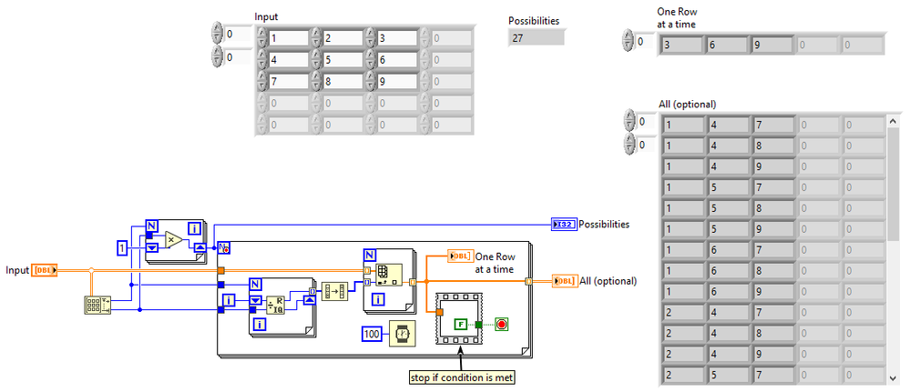

@YoussefAliSabri wrote:
you need to notice that the software will produce row by row because if you try to calculate the whole array when it comes my case (in put array 6*40) the output array will be 6*1600 which will make the software stop excution regarding to the memory allocation.
so giving me row by row result in such way
1st iteration gives(1D array) >>1,4,7; (then I apply the result on my software till it fits the condition if it doesn't it needs to go for the 2nd loop)
2nd iteration gives(1D array)>> 1,4,9;(then I apply the result on my software till it fits the condition if it doesn't it needs to go for the 3rd loop)
.... so on.
Well, you just need to generate them one-by-one, e.g. as follows. (You would remove the 2D output and just process one row at a time until the condition is met.
(Once you tell us your LabVIEW version, I'll attach the VI)
(More general comment: it is not recommended to give an example with a square array if the array is not necessarily square at all times. It is easy to make simple coding mistakes and we won't notice if width and height are the same size during testing).
(5,125 Views)

WOW
just a wow !
Yeah I know this is not the right word and exact word for using permutation. BUT what is permutation(It's a combination when order matters) it's just a general definition to it. so I want was the all combination with respect possibilities(so I called it permutation).
I am using LabVIEW 2014 (32Bit)
thank you for your help.
I just want to know the VI name which in left down corner under the 1st for loop in the left of the whole VI.
Thank you so much!
Matrix size
See attached LabVIEW 2014 version. Please check for correct operations and modify as needed..
