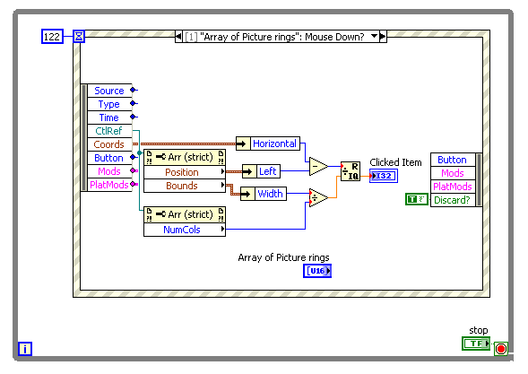

Provided I don't understand why you don't want to use 4 plain controls :),
with the picture array you can catch the button being pressed in a way similar to the following:
...and, if you want, you can change the picture from NotPressed status to a Pressed status (meaning you need a number of pictures twice the number of buttons...)
