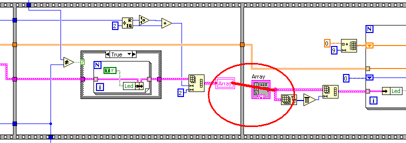

I spotted one problemous area:
Where you have an uninitialized shift register, so for every event the value of the last iteration is used.

Hi dan,
race conditions only occur when you use local variables - no need for a sequence structure here...
The problem is most probably the uninitialized SR of the small while loop inside main event... See attachment for comments!
He was probably trying to avoid a race condition because of using one Local.  It could be avoided by making the Array an indicator and wiring directly.

TonP and GerdW
You are right about the shift register. In the example sent by GerdW, when a 0 constant is wired to the shift register, the code runs properly when I change the lenght of segment value in the slide control. GerdW, you are right about the sign operator.
But I don't know why the leds can't be changed. When I click on the LED it state does not change. A Wait function in my code could solve this issue?
