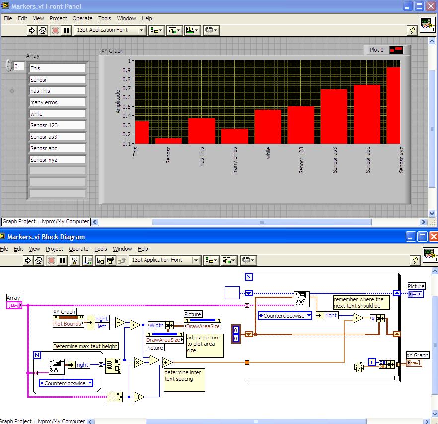

Try looking at this thread
The example is seven years old but it may still work.
