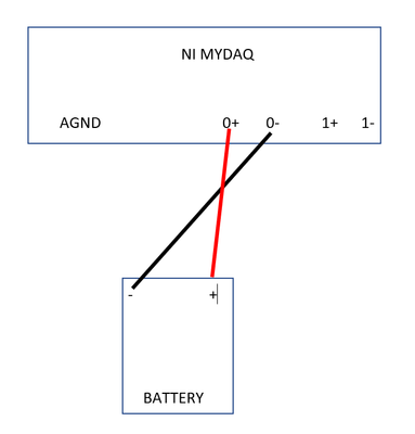

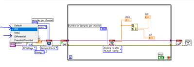

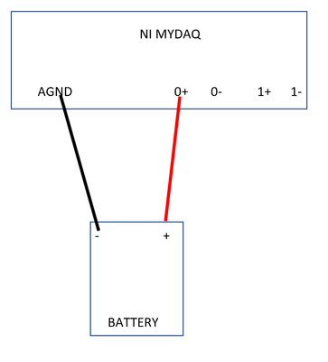

Try wiring like this below, but set your device to single ended or differential as I'm showing with the code below. Each one of these has its own way of wiring as I show below.
Note:
SINGLE ENDED CONNECTION:
OR
DIFFERENTIAL CONNECTION:
Try this schematic above with the attached code. Let us know if it works.
Message 8 of 10
(3,051 Views)
HI GRCK5000, I think youve nailed it with the differential setting, i had a problem with that setting with the daq assistant as well as the Daqmx setup, it would default to default(?), but after adding a control to the Daqmx it seems to allow me to the input terminal configuration with no issues. For some reason though the RSE still reads 0v need to look into that one why (maybe try adding 100k resistor to ground), i've updated the original vi i was writing and this now allows multiple channels and outputs the corresponding values i  need , just still to add in some greater than logic etc to the vi and once i make up the ldr circuits to read the voltage i can determine what voltage values are on and off. i have the possibility now to trial other circuits on the bench.
