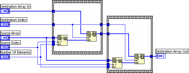

Norbert seems much more familiar with the inner workings or LV memory management than I am, but here's a note about your second example of trying to replace two array subsets with subsets of another array. You noted that LabVIEW suddenly shows buffer allocation dots for both subsets in this case where there weren't any for one subset. My guess is that LabVIEW senses it might need both of these array subsets simultaneously, and as such it shouldn't think of them as the same data to avoid a conflict. If you make the replacement steps sequential (such as with Altenbach's loop or the pic below), LabVIEW can figure out not to make a copy of the array subsets.
My procedure is tedious but avoids allocating index arrays. You could also wrap this into a subroutine VI to limit the overhead of a subVI call. If the arrays going into the subVI are in-place, then there's virtually no overhead involved.
