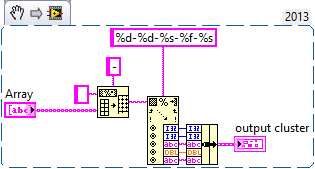

If you want it fast, avoid variant conversion. And of course 'value' property nodes.
This will not automatically adapt to cluster changes, but you'd probably get a broken wire in most cases. And it will be fast...
I'd consider avoiding the conversion, but there's not enough information to propose something.

@Yamaeda wrote:
Wouldn't it be faster to just use Index Array and individual conversions instead of Array to Spreadsheet and Extract from string?
/Y
Maybe. I'm not going to test it Smiley Very Happy. This will be faster then variant conversion\value properties. Your suggestion would be (arguably) more complex, but if even more speed is needed, it would be worth a try.
My guess is that array of string comes from a string to begin with. Not sure, but if so that Array To Spreadsheet String won't be needed of course.
