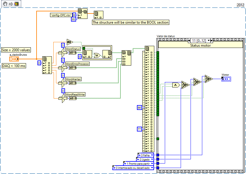

I'm using "Index Array + Stacked Sequence*" to sort and display the data in the Front Panel indicators.
(*Obs: I know that Stacked Sequence is to be avoided, but if I use only wires, my block diagram will have kilometers of wires and will be impossible to change something in the future)
1. Is there a more efficient way to sort and display my data?
2. Does a "For Loop + Case Structure" with several index Array will use more memory (or be more efficient "programmatically" speaking) than this single "Index Array + Stacked Sequence" ?
Front Panel indicators: Index Array + Stacked SequenceFront Panel indicators: Index Array + Stacked Sequence

Right-click on the stacked sequence structure and replace it with either a sequence structure to better understand what you are trying to do, or (better) replace it with a case structure to begin transforming this into a state machine.  At any rate, after doing this, never go back to the stacked sequence structure again.

Hello billko, thanks for your answer. But I still have some doubts in how to replace the Stacked Sequence
About the State Machine: I think it will be not necessary, because the LabVIEW needs to update all front panel indicators each cycle of the DAQ. At the moment I have nearly 30 indicators "spread" in the Front Panel (sensors status + sensor measurement). And I'm already using one State Machine to thread the OPC-UA logic (states: Init, Config, Idle, DAQ, Error). This OPC-UA logic is similar to the example that NI provides with the OPC-UA package. And the sensors are updated only during the "DAQ" state, but in this case all of these sensors needs to be updated
About the Stacked Sequence: I'm really trying to avoid the use of the Stacked Sequence. But at the moment I think only these options can be used:

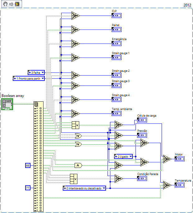

• 1st option. Use only wires: It's impracticable because the VI will have so many wires that will be nearly impossible to modify something.
Let's say that after one month, the user needs to add 5 more Indicators and the PLC gets 2-4 variable in the middle of the array
How can I modify the snippet bellow to add these variables? In my opinion it will be easier to delete this portion of the VI and start again from zero
On other hand, with Stacked Sequence it will be only "Right click: Add Frame After" and we are good to go.
1st option: use only wires1st option: use only wires

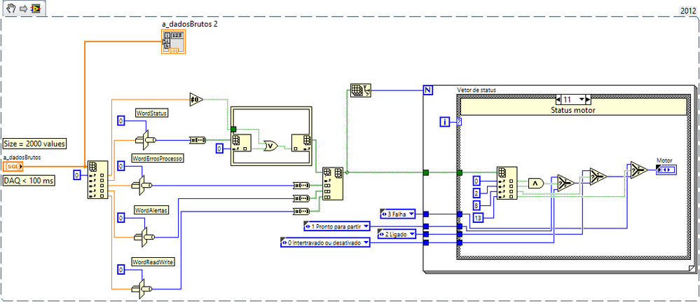

• 2nd option: Use Case Structure. In this case the Case Structure needs to be preceded with a For Loop, right?
So in the end, it will be swapping:
  • "One Stacked Sequence" with 12 frames with only one use of the "Index Array" function... with
  • "One For Loop" with n=12 plus a "Case Structure" plus 12 use of the "Index Array"
The performance of this 2nd option is equal, worse or better than the "Stacked Sequence"? I'm asking this because the VI needs to display XY Graph with several days of data, and memory will be a issue
2nd option Case Structure: Mandatory a for loop, right?2nd option Case Structure: Mandatory a for loop, right?
Am I missing something? Is there a better way to manipulate the elements inside the array relating some elements to others and updating several front panel indicators?
