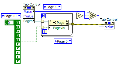

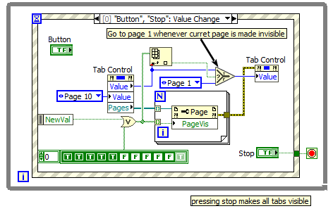

Yes, the workaround is a bit circuitous. Here's how I would do it instead.
(2,170 Views)
For simplicity and scalability, I would even eliminate the case structure and always do the workaround song&dance. Now and combination of visible pages will be treated the same.

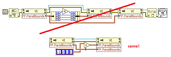

Here's another way it can be done, by resizing the window and restoring it to its original size.

The problem with stacked sequences is that in order to understand the flow, you need to constantly flip through the frames and and have a good enough short term memory to remember all other frames. 😄
All your value properties in frame=0 should be local variables.
Here's how you can do the same size twiddle with much less (and much cleaner!) code:
The problem with your code is still scalability because if you later decide to hide other adjacent or non-adjacent tabs, you would need to make changes all over the code. in my example, all you ever need is change the boolean diagram constant, assuming that tab 1 should always be visible (else we could even switch to the lowest visible tab with a little bit mode code). It is always a good thing to only have a single instance of the visibility loop. Half the code!! You can easily expand to have more than two visibility states, by just indexing into an array of booleans with the state variable.
