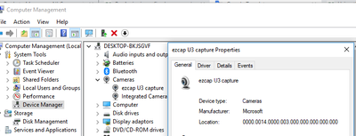

It has device manager properties information as follows
When I test the serial number with NI-Max installed on different computers, the serial number given changes.

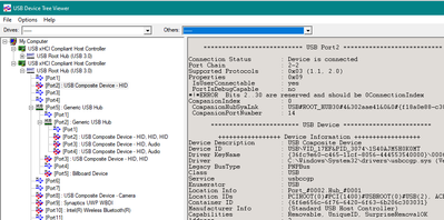

At the risk of derailing this post, there are methods of obtaining what is connected to the physical USB ports... and I have done it in LV a long time ago, before realizing there are better ways. Trust me, you do not want to go down that path.

I'm actually curious about this method. So how can I find the interface name so that it can be used in NI-Vision based on the physical port number?
Does anyone know of a way to programmatically change the name of the assigned camera interface?

Yes, use the System Configuration API.
Read the help file... we don't have YourSystem!
