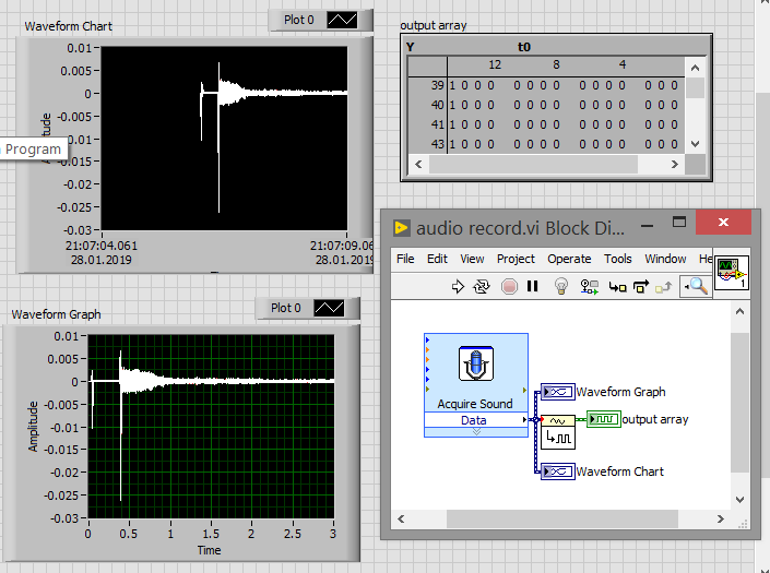

I am trying to convert audio signal to binary signal of 1-D array using the attached block combination.
And what is the problem?
I simplified your VI like this:
Which kind of "binary signal" do you expect?

I am getting a dimensional array of 66147 rows and 16 columns. But I want to reduce it to 1 Dimensional array of single row and 1058352 columns.

That's because your sound is 16bits. You can reshape it to a 1D array with a length corresponding to the product of dimensions, but I still don't see the logic behind all that.

I want to convert it to 1D array so that the individual bits can be compared with a threshold of 0.5v to generate a BPSK signal.

You could help us out by Googling audio bpsk and give us a few links that describe what you are trying to do.
A "bit" only has two states: on or off. There is no "threshold" for a single bit. It really does not make a lot of sense.
