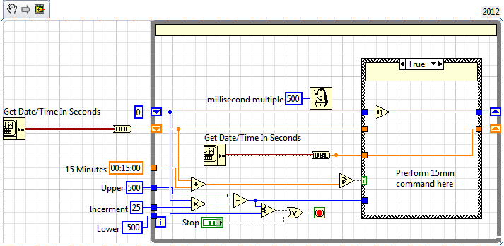

I am not sure if I understand your problem completely. I believe the code below will be a good starting point.

I will try it. To be clear I will explain what I am doing. I have two case structure in while loop 0 and 1 they are my case, 0 is to show exact wavelength value and 1 is to change it. I write 500 and push 1 to chnage wavelength and go back to 0 to show exact wavelength value, after that i write 475 and do some things to change it. I want to make them automatically I mean, in 15 minute the program make it automatically instead of writing number and push button and to it again. bottom line is can i juimp between case structures by time.

Rather than explaining post your code. It is much easier to help you if we see what you have done. It is difficult to explain the codes in words.
