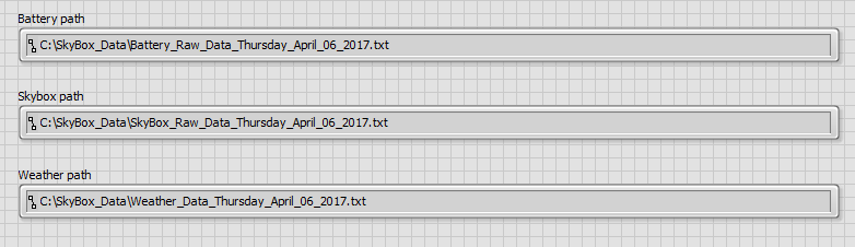

Oh yeah, here is how I generate a filename that contains the day and date.
It's output looks like this:
=== Engineer Ambiguously ===
