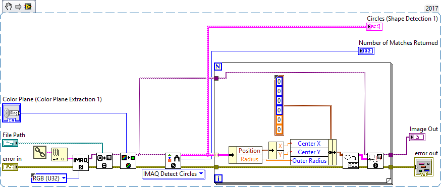

-The sample image you provided contains single circle and it detected only one.
-Please try below and with default values it detects four circles and shows the overlay on the image.
Code modified to show detected circlesCode modified to show detected circlesSample Image with multiple circlesSample Image with multiple circles
