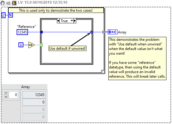

This is the problem RavensFan was suggesting might be occurring (this example is heavily simplified, but hopefully describes the situation):
@jackson040 wrote:
Do you have any ideas as to where I could start looking for this error?
If you can provide the LLB or a download link for the (Omega?) platinum driver I'll take a look. I didn't find it with a quick search.

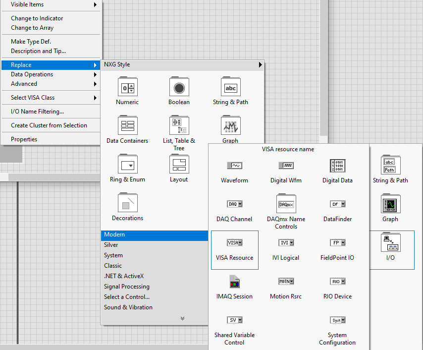

Another possibility...
When you open the Platinum_MB_SerRead.vi, there are a control and indicator with a bunch of values in a cluster (labelled SerHandle).
  • Right click on this control and choose "Open Type Def."
  • In the new window (Platinum_MB_SerHandle.ctl), right click on the "VISAResourceName" and then choose Replace > <preferred style, I chose modern> > IO > VISA Resource Name
  • The VI (possibly visible behind the ctl window, depending on your screen layout) will have this control become faded/grey.
  • Save and close the .ctl file (you may receive an additional save prompt when closing)
  • The VI should update to have the same datatype (VISA Resource instead of String)
  • Retry the application.
I'm uncertain if the string holding your VISA Resource at present is losing some information about the connection - by making this change you can ensure it remains in a proper "VISA Resource" type.
Message 28 of 35
