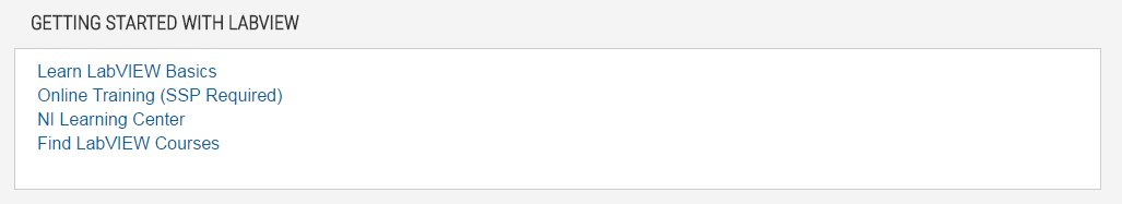

Look at the links when you first open the LabVIEW forums, and those will give you a good start. If your employer has an SSP, that will give really good content as well. Going through Core 1, 2 and 3 will set you up to do a lot in LabVIEW. (You actually have to do the exercises though 🙂 )
