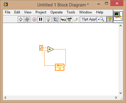

The reason you are getting feedback nodes is because you are plugging the output of something into the input of the same logic. It's like using x to solve for y, but x is determined by what y is. You need to know Y BEFORE you can solve for X so labview is trying to fix this problem by adding feedback nodes.
Specifically you have an indexed number feeding out of the top for loop being used to set the Time Target on the elapsed time VI, and using the Time has Elapsed? boolean to determine how many iterations to run the for loop from before.
Here's the simplest example of what you're doing.
You need to look up shift registers and how they work. Any data that you want to save from iteration to iteration of the loop for logic put on a shift register.
