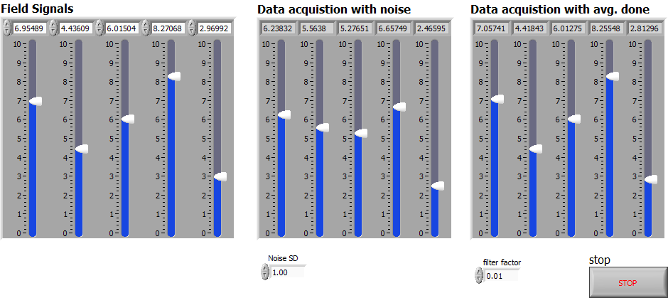

I have a 48 Analog Input Channel DAQ system, I am reading at a rate of 1Khz. (The data has to be datalogged at 1Khz).
The signal received are with noise and to display to user without much fluctuation I am averaging the values using 'Mean Pt by Pt' API.
I am attached the VI wherein I have considered only 5 Analog Input which is simulated by a pointer numeric control. In producer loop I am purposely adding noise and storing the data array in a variable named as "data acquisition with noise".
In consumer loop I am applying the averaging method to individual analog input by the help of 'mean pt by pt' API.
The VI solves the purpose but for 48 Channel it becomes messy by using 48 'Mean pt by Pt' API.
How do I optimize the code so that with a single API I can get averaged values.?

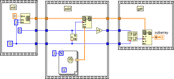

I'd make a 2D circular buffer (search the forum), size Channels X Length. You'd get a history of 10 for all channels, and you'd be able to get an average at any time.
Spoiler
As an example circular buffer:
The data between the sequences (there only for illustration) can 'live' in a DVR, or in private class data or a cluster in a shift register.
Theoretically, you can keep the sum of all data, and subtract the earliest point when you add the newest point. That will save a lot of calculations. However, once you get a NaN, Inf, -Inf, or mixed small and large numbers, the sum is corrupted, and it won't work well.

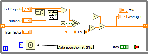

Maybe all you really need is a simple and inexpensive exponential filter.
(adapted from my old post here)
Note that the filter factor  control could be defined as 1/alpha (where alpha is in the range 0..1)) so a higher number increases the smoothing
Message 7 of 33

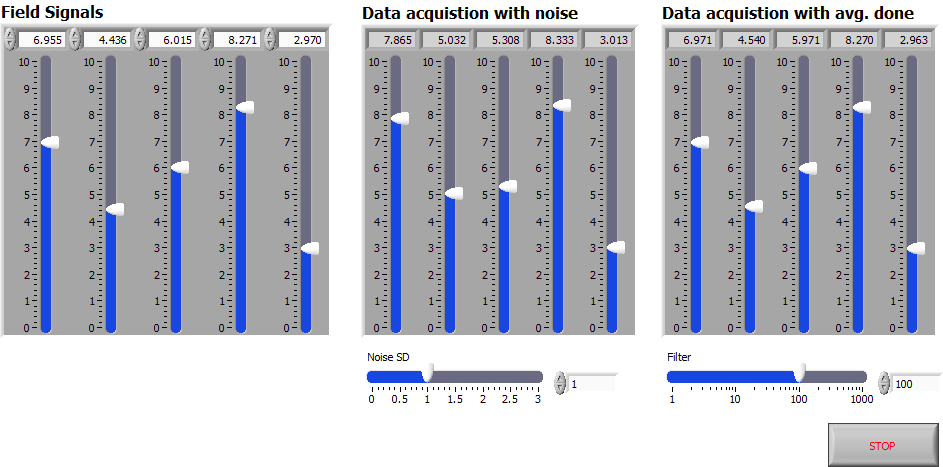

Here's how that could look like:
Message 9 of 33
