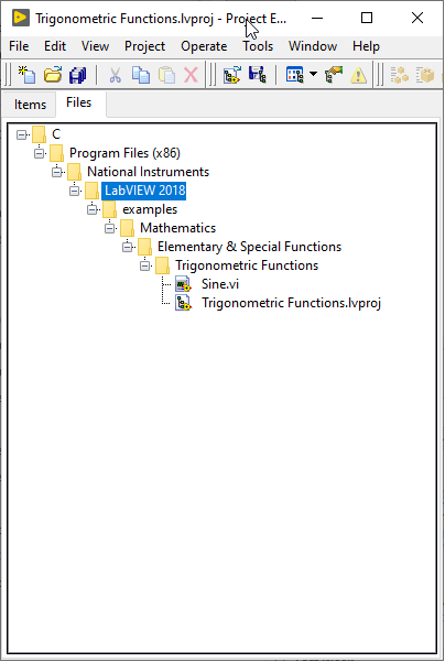

I don't understand "View File Path" option.  I don't think you mean the project's "Files" tab I was referencing.
This is the Files view (which I never use, haven't even looked at that in any project in years).

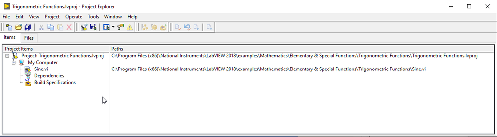

And this is the project view (Items View) with Project->Show Item Paths enabled.
I'm not really using those paths all the time, but for projects that I haven't created myself it can be helpful to be able to control if files belong to some group based on the directory they are in (and then fixing the mess) so it is more consistent.
So unless you were talking about something else than the first image, I'm standing firm on my statement, that the Files view is not necessary at all to be able to maintain a clean project files structure. And I'm not arguing this with you as you like to want to. If you feel different, that is totally fine with me. Do whatever you feel more comfortable with. But you asked for our opinion and kind of chided on Santosh (if not even tried to belittle him) for not taking your bait about who agrees or disagrees with you.
I enable "Show item paths" because it makes it painfully obvious to me if I placed something in a library but in the wrong physical location.  All the files there will have the same path except for that one, and it sticks out like a sore thumb.
