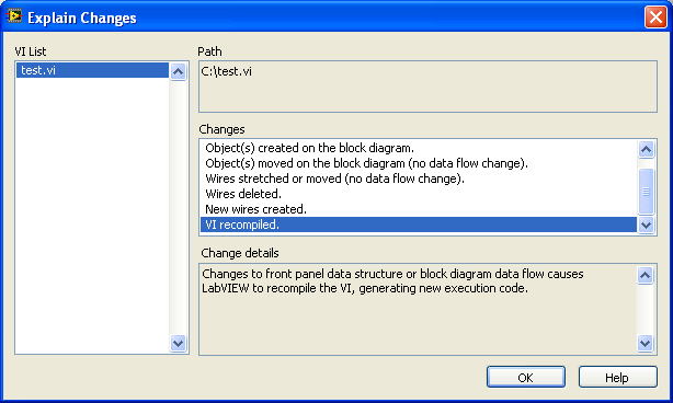

I would like to recommend to do following:
- Open Front Panel of the VI which needs to be recompiled
- press Alt+F4 This will invoke Save Dialog,
- click "List unsaved changes"
now you can see what changed and why VI recompiled, for example:
What is reason for recomiling in your case?
regards,
Andrey.
