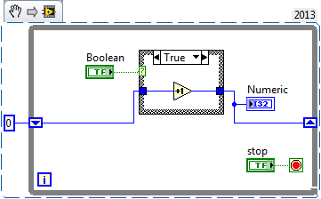

Gracias por utilizar los foros de National Instruments! Tal como Altenbach menciona, necesitamos mas información sobre lo que deseas realizar. Esta señal booleana viene de un LED fisico o es una señal de control de software (bandera)? Te hice un ejemplo muy sencillo de como podrías comenzar pero todo va depender de lo que desees realizar.

LuisC_AE wrote:
What is the purpose of the "equal true" function?

Hi Luis,
you made the classic Rube-Goldberg: IF "Boolean equal to true" THEN true ELSE false… 😄

Oh yeah! My mistake lol. It was very very quick example that I didnt even notice that "double" verification. Eduardo you can get rid of that verification, here's a better code:

SInce we don't really know how the LED status is read by the code, "latch action" might be unrealistic.
Here's a code alternative that works for any type of mechanical action. (currently set to switch until released, like a car horn ;))
NOTE: The code would be even simpler with this idea implemented. 😄

Thanks Altenbach! That is definitely a better way to go.
Eduardo, hope you find these examples useful for your application or project.
