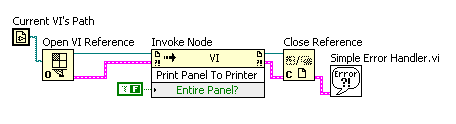

  • You mention that you are using a VI called "Print Front Panel.vi". Since this VI doesn't come with LabVIEW, please let me know if you get the same error when using the method shown below. You can simply add the code to the VI instead of the printing VI.

My code does exactly the same as the "Print Panel.vi" so replacing the code wouldn't change anything. Do you have the answers to the rest of the questions from my previous post?
