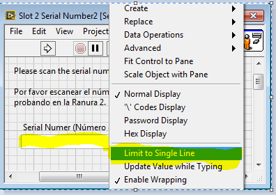

For completness for others.  Most bar code scanners read the code and add a "Return" to the end.  just as if someone typed the data from the bar code and hit return.  The "Return" triggers a value update(AKA Value Changed) IF the "limit to single line flag" is set on a string controlSmiley Very Happy
By taking advantage of the Value Change Event triggered by the scanner's added "Return" a lot of CPU usage can be freed up from the code and, it works with much less effort on the LabVIEW Coder's part.
Some of those "Unique" string control properties, like "Limit to single Line" and "Update value while typing" are fairly intuitive in English-  I don't know about other languages- HOWEVER, you have to know they exist to use them!
