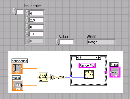

If you have multiple ranges, one easy way would be to use threshold array on a sorted array as e.g. shown here. Modify as needed.
(see also http://forums.ni.com/ni/board/message?board.id=170&message.id=232911#M232911)
Message 9 of 9
