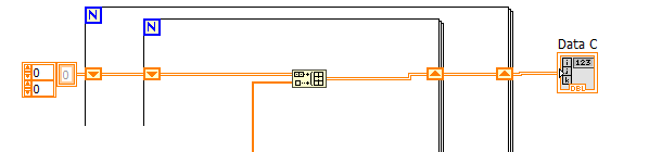

Typically we just append rows to an initially empty array as follows.
Hard to tell exactly what you want, but appending columns is typically inefficient because of a constant need of copying data in memory. You can always transpose at the end.
