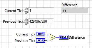

If you store the tick count as a U32 (not coerced to double), you can do a subtraction of the two and not worry about the roll-over condition*. For example if your previous tick value is just before the U32 rollover (say 4294967290) and the following tick value has rolled over (say to 5), then the difference is calculated correctly as 11 ticks:
*Of course this won't help in the case where your previous tick is from a previous roll over (ie more than ~50 days ago), but it's probably unlikely you won't have some sort of flow in that time period.
