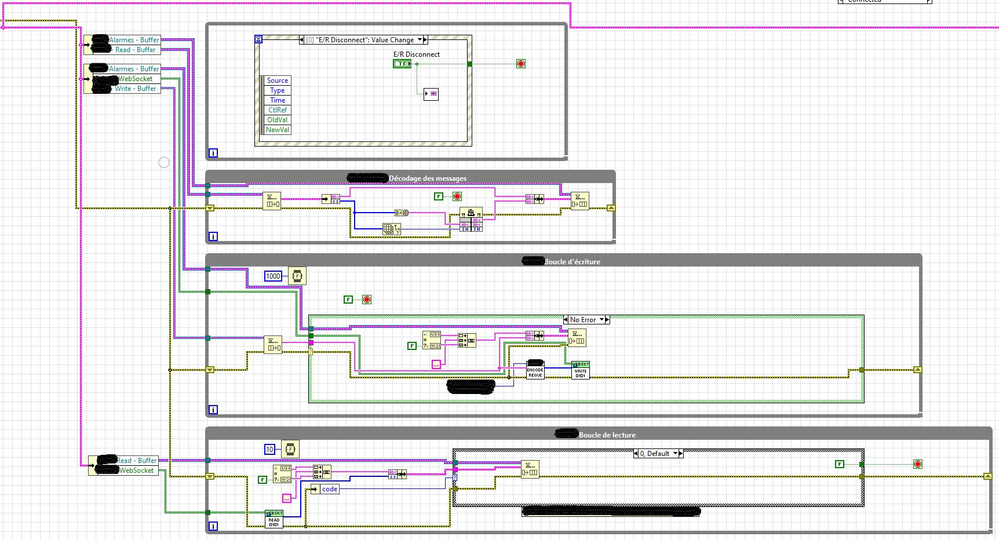

I find the first one the most interesting but it causes problems in the loop that only reads the websocket. I have to read an element to know if I have to stop my loop and I don't like that.
I modified your idea to make a queue shared between my 3 loops and which would contain the state of the loops (each loop having now a running state and a disconnect state). When I want to leave my loops, I just have to tell my queue to switch to disconnect state. This works well for one loop.
In the notifier as demultiplexer example, LabVIEW explains that to guarantee that the state is given to the loop, it is necessary to use queue and not notifiers.
Maybe you can help me to understand that I can't receive my state on my 3 loops.
PS : I don't use a dequeue element but a preview queue element

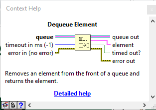

My dequeue element were in timeout -1 so it was blocking my loop. So there's no way to kill a while loop while keeping dequeue element timeout at -1?

Using the notifier though you cannot use a -1 for your dequeue timeouts for the command queues. If you did you would never see the because queue would wait forever for a command. This is one good argument for using an explicit stop command. The downside is that your primary loop will have to format and queue the stop command for every queue in your system.

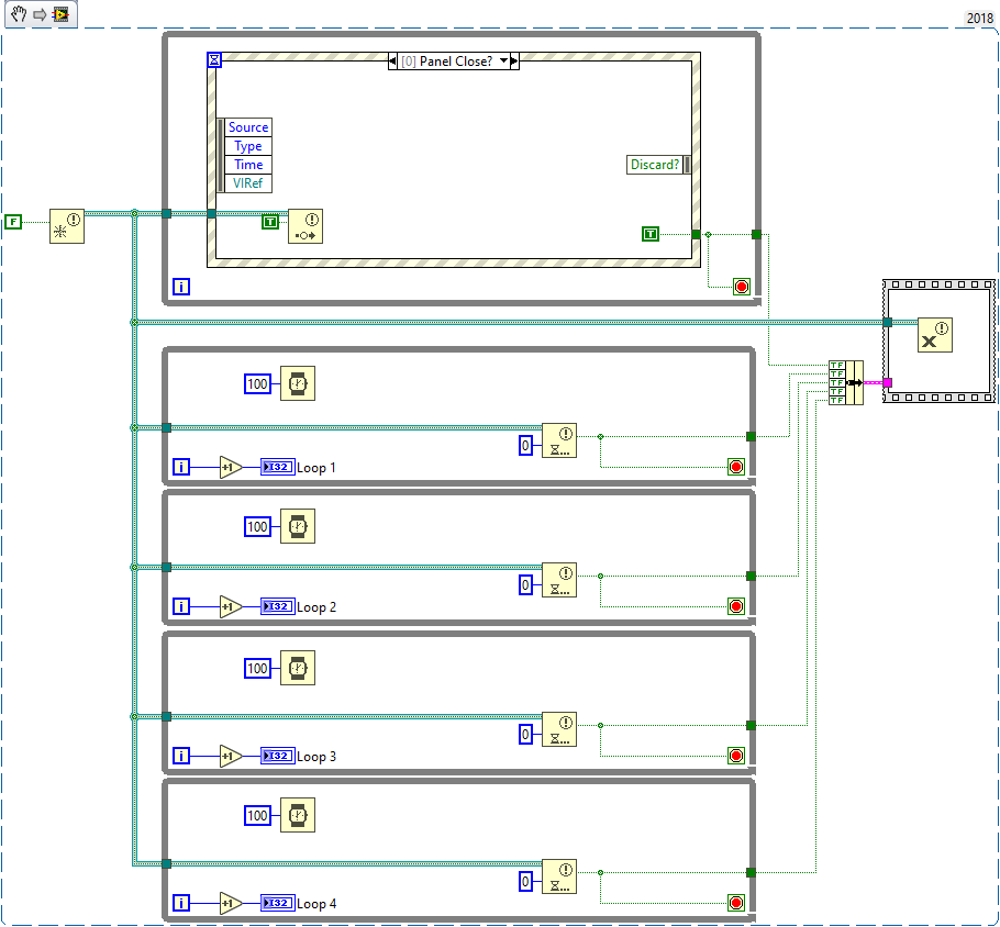

Here is the basic format for the notifier.

Curiously, you already have a (disconnected!) channel writer in the top loop. What's the purpose? You definitely could use a channel too.
Are all three lower loops (A) asynchronous, operating on completely different tasks or (B) does a single element transverse all three loops in sequence? (dequeue, process in loop 1, enqueue, dequeue in loop 2, process in loop 2, enqueue, dequeue in loop 3, process in loop 3, etc.). In case (B) you could just use a singe consumer loop and some pipelining architecture

KISS!
You have queues already that you can wire a timeout to. I would get rid of the waits, and have the dequeue elements timeout set the rate on the loops. There is a "Timed out?" output you can wire to a case structure if you need to do some regular update in the loops. You can have a stop command, or wire the error of the dequeue elements to the stop and be aware of where you release the queues. Some people might balk at the idea of having some other error on the dequeue element, but in my book any potential error there (other than from releasing the queue) is a no-go bug and should not leave development.
