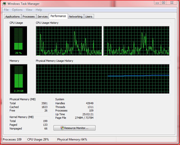

Oh no!! all of my computer's resources are used up polling for events!!!

Thanks for the sarcasm, but before you make comments, try running the code with only 1 event structure.
Some programmers try to make code efficient as well as functional
