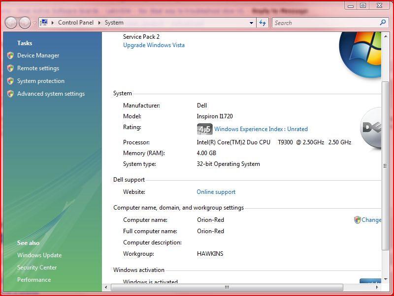

My memory usage is high because I run a PLC programming software, HMI programming software, Email client, web browser with 10+ tabs, Kepserver, NI distributed system manager, and LabVIEW.  I have 4 gigs of ram, so it's no sweat.

That memory usage is scarry to me as well. You have turned on the switch to makes Windows 3Gig aware?

my tags are set to update at 500 ms, no difference at 50ms.  Why is my memory usage such a concern?  I could open up autocad as well and keep running.  I prefer to have all of the programs I use open to save the time it takes to open them every time I need them.  Is there some legitimate reason not to use my computer the way I do?

In your task manager, the memory use seems to increase constantly, If this continues, you will run out of memory. (see also).
Are you on a 64bit OS?

I use both task manager and process explorer.  My computer's memory does not increase constantly.  If you are referring to the screen cap I took that was me loading a yet another program after I started task manager to capture and save as a jpg.  I never run out of memory on any of the computers I use regularly.  I have a laptop for performing music live, it does all of my instrument processing and vocal processing real time.  I have a desktop for recording audio and manipulation of audio and video.  And I have this work laptop, and I put them all through the paces, but I know how to manage resources.
My UI is very responsive.  It's just not getting the values from the OPC server fast enough.
And I am aware of the memory limitations of 32 bit OS.  But I am also aware that until you hit the wall, performance is not effected.
