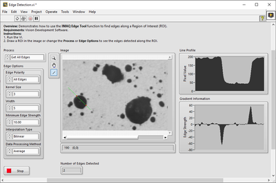

See the Edge Detection example where the ROI is a line under a certain angle. This requires resampling because edge detection works on a 1D array of pixels.

Given that the ROI is a line, the pixels underneath the line that belong to the image will form a 1D array as I understand it. What role does the interpolation play in this sequence? Why is the resampling needed?
(1,121 Views)
I think it's reasonable to assume the 1D array should contain values that are equidistant and therefor resampling is performed along the scan direction, but that might not involve this interpolation input.
The VI help documentation (https://www.ni.com/docs/en-US/bundle/ni-vision-2020-labview-api-ref/page/imaqvision/imaq_edge_tool_3... and Vision Concepts (https://www.ni.com/docs/en-US/bundle/ni-vision-concepts-help/page/edge_detection_concepts.html) don't explicitly say how it applied so the best way to find out might be to experiment on your own.
