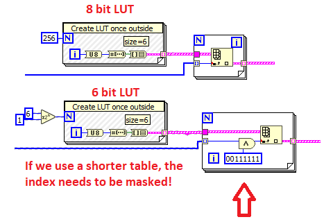

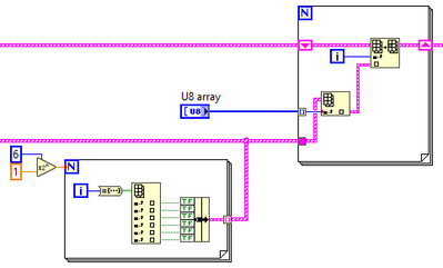

Pre-generating a lookup table array seems to beat Solution B (as-posted) by about 2x:
Careful there! If you use a 6 bit LUT, the index needs to be masked to 6 bits because in the current example the indices can be any 8 bit value.
Of course in the real application this might not be needed, assuming the number is guaranteed not to exceed 6 bits (0..63).
Note that the LUT generation is "constant folded", i.e. replaced by an array constant in the compiled code)

@mcduff wrote:

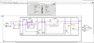

Looks like the LUT method is leading by a significant margin (and I'm even giving the LUT a handicap by building it each time).  Props to @MertMcMahan and @altenbach
Make sure you turn off debugging and the LUT generation will be constant folded, i.e calculated once at compile time.. No penalty.
