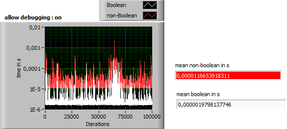

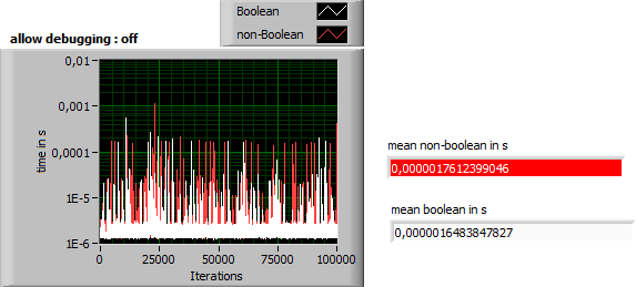

Hi ouadji!
I did a benchmark of the two .VIs shown in message 15 (Boolean) and message 17 (non-Boolean)
and here's what I get for "allow debugging: ON" and "allow debugging: OFF"
Alex
