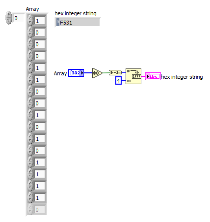

If you want a hex format string  (normal string display!), use this instead:
