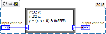

@Barionics wrote:
I am attempting to convert a CRC calculator, written in C, to a LabVIEW VI.
It looked easy to cut and paste the relevant calculations into a formula node, but I have come unstuck.
in C I can do:
ushort value = (ushort)(I<<8)
The second 'ushort' is there to remove any overflow characters by chopping it back to 8 bits.  I tried replacing the ushort with uInt8 but no joy.
If I do without the (ushort) LabVIEW recognises the overflow and rounds the byte down to FF, which is not what I want.
The LabVIEW logical shift operator does work correctly, but, as the code is more subtle and clever than I am, I don't really want to go down the spaghetti route if I can avoid it.
BTW, don't think I hadn't thought to convert the C code to a DLL and import it that way, but I would need outside help with that, plus the complication of supporting the code.
Any help much appreciated,
  Ian
Is this what you are trying to do?

@Barionics wrote:
Fantastic!   Thanks for your efforts.  I can't wait to try it!
But I must ask the question again, how to get it into LabVIEW without having to draft it all in line by line?   I tried cutting and pasting the PNG and looked for a POOF option (or even PROOF?) but no joy.
I must be one of those daft things which you have to just know and I'll be slapping myself.
I think the use of "poof" was meant to be exclamatory, like a magician saying "POOF!"
The problem is that changes made last year to the forum software have broken snippets. Most of the time the image the forum shows you has been rescaled or had the LabVIEW code stripped from it, so you can't just drag or copy-and-paste it into LabVIEW anymore. It is still possible to save the image to disk and then open it in LabVIEW. There's a whole discussion about it here: https://forums.ni.com/t5/Feedback-on-NI-Community/Snippets-are-broken/td-p/3658760
