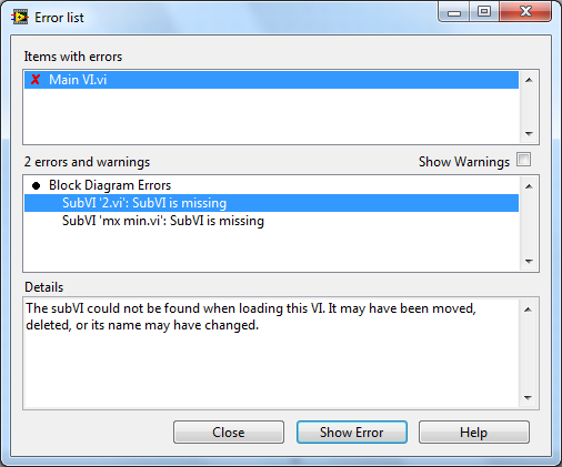

      Sorry.. Please find the attached files now.
