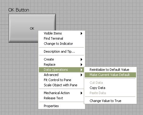

You can use a invoke node and select "reinitialize to default".

make sure that all your boolean buttons have the property "Latch when released" (offcourse based on your application)
Or there might be a chance that you have created some locals or property nodes which are wired with a true constant
