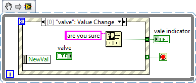

Thank you. I will give this solution a try using space bar + mouse click.
