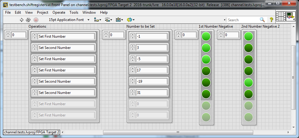

I put together a small testbench and ran it in 2015 and the FPGA and Desktop match execution behavior. Can you run this testbench in 2012 (which I don't have installed) and see if the results are different.

Thanks for the update, @MJ. I'm glad you were able to find a solution to your problem. Just to be clear, you tried the testbench I attached above and it fails in your install of LabVIEW and LabVIEW FPGA? If so, I'd like to track that issue.

No, I did not try your testbench.  But I am sure non-initialized shift registers do not store the previous boolean states correctly for me when using LabVIEW FPGA 2012.  The readback from the non-initialized shift registers at the start of my VI are always TRUE, regardless of the previous recorded states.
