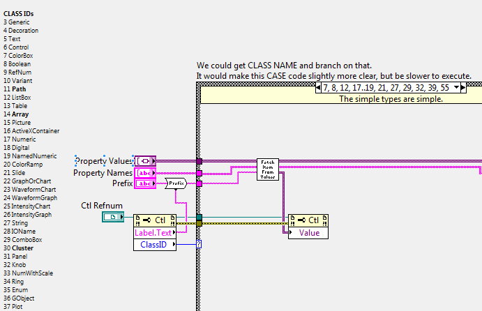

For most types, the code to WRITE it is very simple:

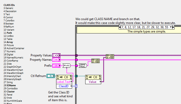

When reading, it's equally simple for most types:
the properties are all VARIANTS - I simply feed the variant to the VALUE property of the generic control, and it's all good.  Again, some other types (clusters, arrays) are a tad more complicated, but that's not relevant here.

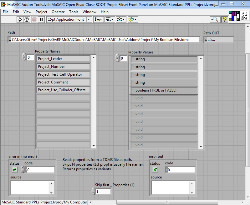

When I write the file from my LabVIEW app, here is what the property looks like:
It shows up as a BOOLEAN. That's right, with a TRUE or FALSE value.
Great.
Again, if I read this file right now with my LabVIEW tools, it's all good.

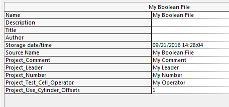

But DIAdem insists on showing it as a 1 or 0, not TRUE or FALSE:
That's STILL OK, because the users can understand it.

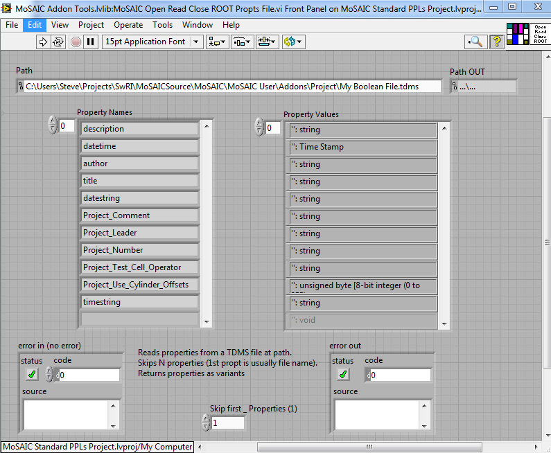

The problem is if they EDIT the file, in ANY way, then look what happens to the Boolean when LabVIEW reads it back:
Yes, the edit added some new properties, that's OK.
But it changed the boolean into a U8 !
And, of course, feeding a U8 variant into a Boolean control results in a false always (and an error, I suppose, but I'm not checking.
