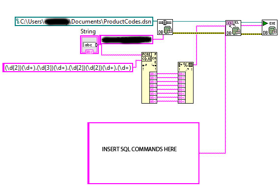

So something like this as a starting point?

Sort of but I don't think the way you have it wired would work. From the picture it looks liked you have effectively concated all the component parts of teh serial number back into a string with only the '.' missing. THis looks like it is wired into the table name of the select VI. It is dificult to tell where your SQL stuff is wired.
I suggest you do a little reading up on SQL in general. This will help you quite a bit. Beyond knowing your schema I cannot give you any more detailed advice. Yes, I know portions of the serial number are keys in separate tables. But in order to write SQL one needs to know table names, column names and their relationships.

Ok. I'll read up on it. I thought I could get the wiring down then work on the SQL command, but from what you are saying getting SQL down will help me figure out how/where to wire?
Message 19 of 38
(1,070 Views)
Yes, a basic understanding of SQL will go a long way in helping you actually use the DB VIs. You also need to know some specifics about the DB you are working with. This is one reason I highly recommend using stored procedures. If you are not responsible for the DB itself you may want to ask the folks who are to provide some stored procedures for interacting with the DB. They tend to be much easier to understand and use as well as hide all the SQL and schema specifcs.
