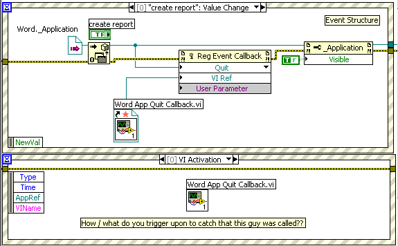

Getting much closer..  The callback example is where I'm at..  Works well... opens word.  closes it..  calls the callback VI which pops up the message.  It's almost there.
How do you genenrate a trigger from the Strictly Typed VI created by the Reg Event Callback?
It's hard to describe what I'm trying to do.  So with reference to attached image, pretend that the event "create report" is one of the state in the Event Structure and "VI Activation" is another event in the same structure.  So the attached image would represent two pages from the same structre (easier to show this way).  How do I get the bottom Event Structure to trigger only from the desired User Event (Word closing) which is generated from the one pictured above it?  The reference in the top one is for the VI at the bottom.  I realize VI Activation VI is probably not the event to choose..  (it triggered by clicking on the block diagram.. 😉 )
Since the VI being referenced by the Strict Type does not allow to change the connector pane (ie add terminals), which could be used to set a change of value to an known indicator; how do I trigger a LV event within the Event Structure??..

As to your question, one simple way to do it is to use the User Parameter item for the Register Callback. You can pass it a control reference and in the callback you can write to the "Value (Signaling)" property to trigger an event. This requires an extra indicator on your front panel (which can be hidden), so some may see it as crude, but it works, and it's simple. See attached updated VIs for sample.

The only other thing to watch out for is that all callback VI's are inherently reentrant and they run in their own application instance of LV. I found this out during my current project using teststand. Drove me crazy trying to figure out why somethings would work and others would not. Just something to keep in mind.
