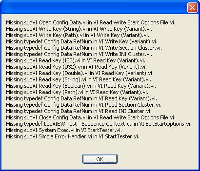

The issue is, that I have some code that runs fine in my developer version of LV 8.6. But as soon as I compile it into an .exe file and tries to run it, I get a broken arrow and a message about several missing VIs. I have tried to force a recompilation of the VIs in question and resaved them all, so the references to the VIs should be fine. And as mentioned it runs fine in developer mode.
I have attached three screen shots below, one showing the application running in developer mode, one with the broken arrow, and one with the error messages returned. I have also tried to search both the forum and Google for the problem, but can't find any similar issues, so any suggestions would be appreciated.

Hi Martin,
all vis are from vi.lib, so ther eprobably something went wrong on building the executable.
Could you try to separate the problematic subvis (ReadWrite StartOptions and StartTester) and make a smaller build of them to verify the app building is ok?
